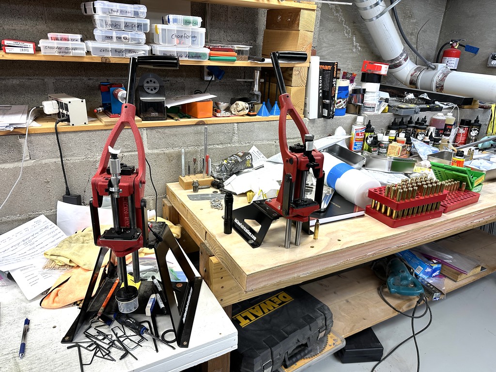

They are both good presses,I own them both. The RC gets the bulk of use just because I’ve been using it for 32 years and it’s like old friend, plus it produces ammo with very low run out. I’ve always been curious if the Co-Ax and used mine for about 6 months straight, I still use it once in awhile but ol green is my sentimental favorite. I seat most of my precision ammo on an arbor press with Wilson dies. The Dillon 750s handle high volume ammo like 9mm, 45acp, 10mm, 223 etc. one addition to the man cave I like a lot is the inline fabrication stand, it makes swapping presses a one minute job, very handy.

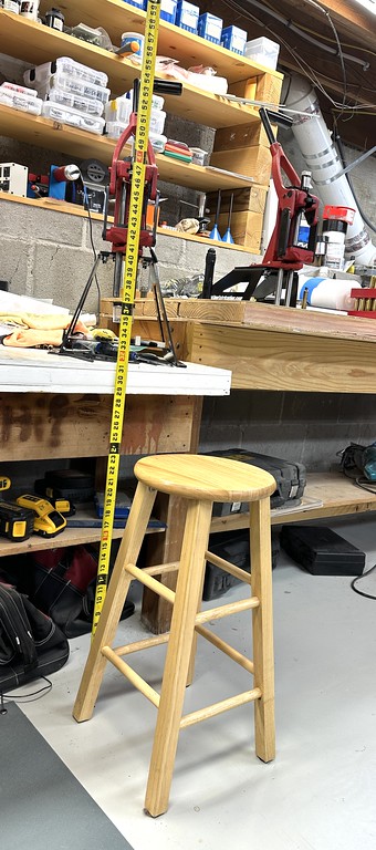

Those stands must make reaching up to work the press very tiring. The Co-Ax is already quite a reach up, mounted how and where it is supposed to be mounted.
Danny
Danny
I operate the presses either while standing or sitting on a tall-ish stool, and have never had a problem with height. Never even thought about it possibly being uncomfortable. I load mostly in small batches of 10-20 rounds, so maybe that is why the handle height is not an issue for me.
