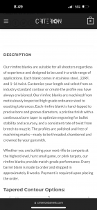

I’ve shot one match (ABRA) with my 2500x with a Criterion barrel. I shot a 199 and a 198 with a lot of CX that isn’t my favorite. It outshoots the two Shillen Ratchet barrels that I have for that rifle. I called Criterion and they are button rifled and hand lapped.
I thought about trying one but I have a barrel on order with Muller and having three now I just didn’t want to roll again. lol.
The price on them was quite good I thought. I talked to a guy and he said he was going to get one and try them. So maybe next year we will hear more about them. But one place had . 900 blanks in stock for 315.00. Natural if they start winning it will go to 450.00.
