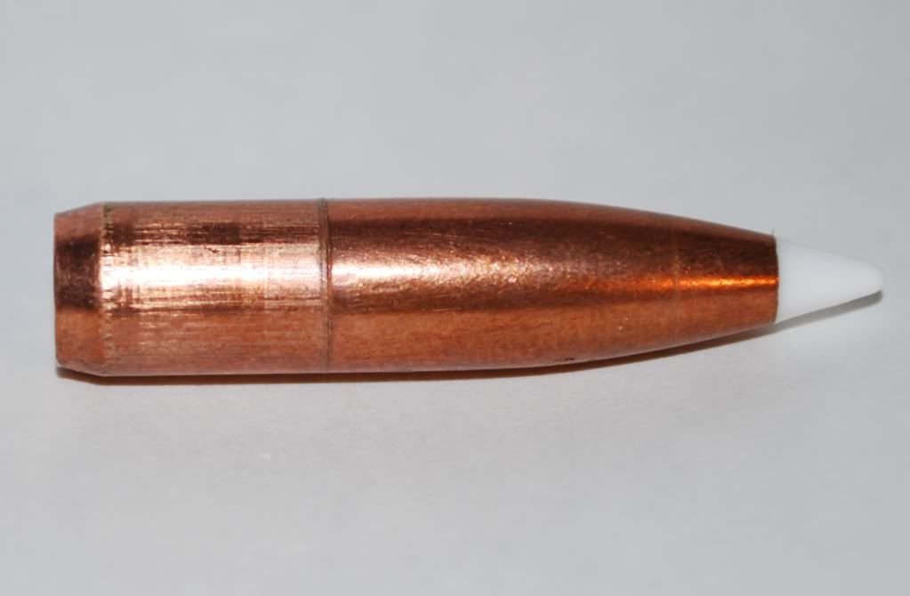

I think I have come across what you are talking about. With my Lee reloading Hand Tool kit. The sizer does not have an expanding ball. When the neck on my case got thicker it shaved some copper off the jacket of the bullet. Since then I have bought a press and normal RCBS dies. That’s a 140 gr. Nosler Accu-bond bullet I pulled.
"stinky": I can also see the ring around the ogive from the seating stem, although on this example, looks like no real damage. And I'll bet that after seating that bullet if you looked closely around the mouth of the case you would see very tiny copper shavings, evidence of the damage done to the bullet.
What part of the bullet is the "ogive"?
Sorry I'm new to shooting and reloading.
Thanks a ton for your help.
Annealing is something to consider, but I can't comment on that, have never annealed a case in my life, and too old to start now. Not for any anti-annealing beliefs, but because of my limited knowledge & ability. If you have a tubing mic or some other accurate way of measuring neck wall thickness that may be a good idea: compare new versus 6 to 7 loadings.
Ogive is the "curved" section of the bullet, from where it starts to reduce from the .277" 270 cal. full diameter to the tip. Just held a ruler up to your picture and the ring appears 3/4" from the polymer tip/ copper junction.
Thanks.
I saw the rings and I assumed that they are normal. Is that normal or do they normaly seat with out leaving marks on the bullet?
This will identify that part of the bullet that is the ogive: http://media.photobucket.com/image/picture%20of%20freebore/Tomate_08/freebore2.jpg
"stinky": If your bullet seating is "normal"/ neck ID around .002" smaller than bullet diameter, then no, you would not normally get the ring. The exception would be if you were using varmint bullets that have a very thin jacket for maximum expansion, then the chance for the ringing would be greater. Another cause would be if there were a poor fit between the seater stem contact surface with the bullet. As long as it's nothing more than a ring mark without any indentation into the copper jacket it would not be a problem.
