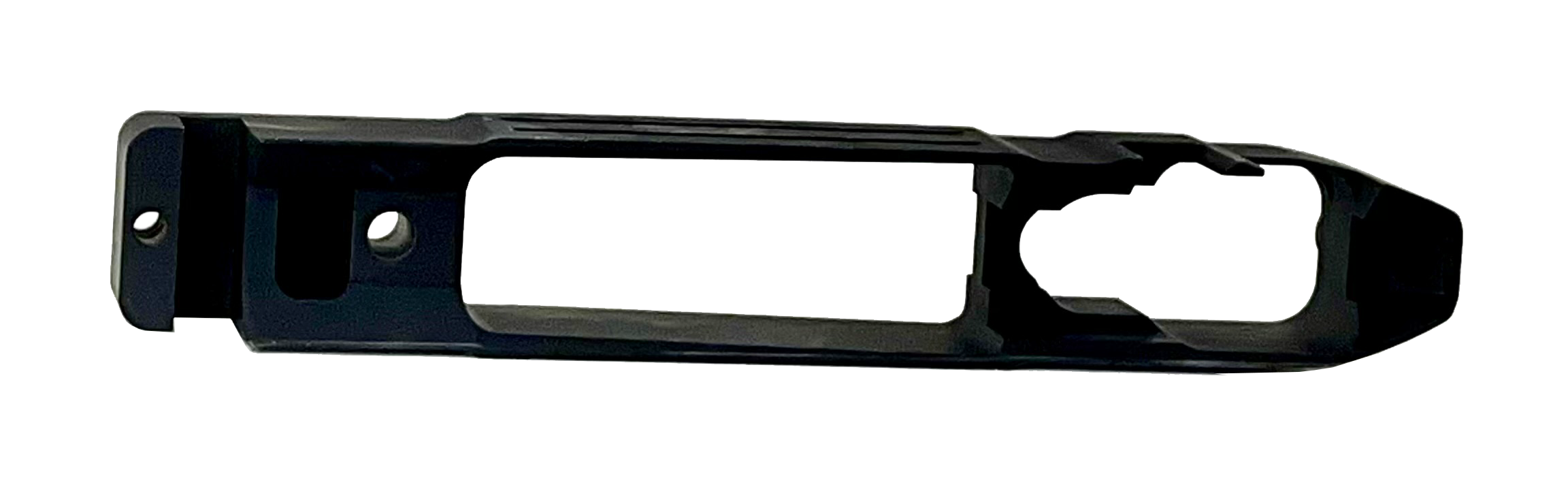

Has anybody removed a Mini-Chassis from a Manners stock? How did you get it out?
I have one that runs a little cock-eyed and I have a Badger EFR in the forend so I can't simply sand one side of the barrel channel down. And of course I've waited until last minute so I don't have time to let them fix it.

It's definitely glued in. I should have given a little more info.
It's just an aluminum block glued into a cavity with what appears to be a Devcon or Marine-Tex type epoxy and a few screws through the side to help hold it.
But I'm not sure how to get the epoxie to release. Would a heavy duty soldering iron strapped to it do the trick maybe?

I've had a few actions and barrels in it and they all hug the left side. You can see that the epoxy between the Mini-Chassis and the stock is thicker on the right side towards the front. It looks like there is enough clearance to reglue it in a more centered orientation. Just need to get it out first.
If you are going to do that then you better order another one now for when you ruin the one you have trying to fix it. LOL Mini chassis do not come out.
Not a secret. Manners put up pics of them on their site.

Not at all how I envisioned the setup. It’s almost as if it pivots on the screws/rivets, makes me wonder why they have the screws/rivets at all.
I think it's just extra reinforcement and they probably aren't tightened until the epoxie has set.
