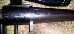

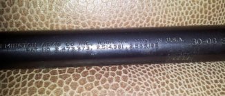

The left side of the barrel reads "U P R 30". Action serial #6284676. Bolt does not have anti bind slot.

Here is a pic of the side. Hope this helps. That is cool to hear the stories of 50+ year old rifles.
U= the assembly code PR = either june of 1924 which is impossible and 1968. Cant figure out what the 30 is yet. Are you positive it is a 30-06?I need a pic of the other side and the stock if possible.

Remington dates model 721 serial number 6284676 as 1953. Historical info. can be obtained from Remington at 1-800-243-9700(select prompt #7). I believe the anti-bind slot for the bolt lug was an early 70's design change for the model 700.
You have an unusual barrel marking and serial #. The manufacturing date code is stamped on the LH top rear of barrel. It is 2 or 3 digit, month first then year. There is no U month code and no year PR that I can find. There is a PP (1945) and RR (1946). Month codes are all single digit and year codes are 1 or 2 digits. The serial # also appears very long.
My 721 30-06 is marked C ZZ 44. It was made in APR 1953 and I personally bought it in 1953. I do not know what the 44 means and suspect it corresponds to the 30 on yours, having nothing to do with the caliber. My serial is much shorter than yours, 309207.
The factory in Ilion, NY may be able to clarify it for you.
It is a most unusual barrel code and receiver #. Keep us posted with your findings.
Bill
After looking closely at your receiver#, I think it is not an original Remington marking. The numbers are too bold and the characteristics are different than those on my rifles. It looks like someone else has stamped this receiver. Let other members with original 721-722s look at their numbers and compare with those on your receiver.
