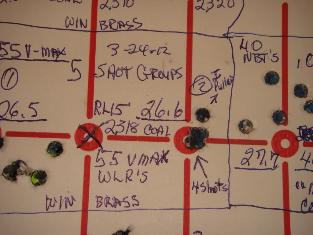

223: I tried NBT's and V-Max's this weekend. I found a great load in by 223 9 twist using 55gr V-max. Still going to work on the NBT's as I believe there a little more destructive, just a little!
I screwed up the shot in the 1pm position, all five shots should have been in there!
Here was my best group from this weekend from my 700P .223 with 69SMK's at 100 yards. Little torn up and muddy from the wind. I left it on my target stand in the back of my truck while driving home. Its a thin paper target. Gonna start using cardboard instead for better bullet hole showing. Im very happy with this Remington 700P!!!

How do i measure groups? Is it from the 2 farthest rounds outside sides? I see some people minus .224 for the bullet diameter (I am shooting a .223). Or is it from the center of the 2 farthest rounds? Just by looking at the picture of my group with the dime next to it above. What would u guys guess it would be??? Under 1/4MOA ???
Looks like its .3-.4. The way I do it is measure outside to outside and subtract the bullet diameter. In your case would be .224.
