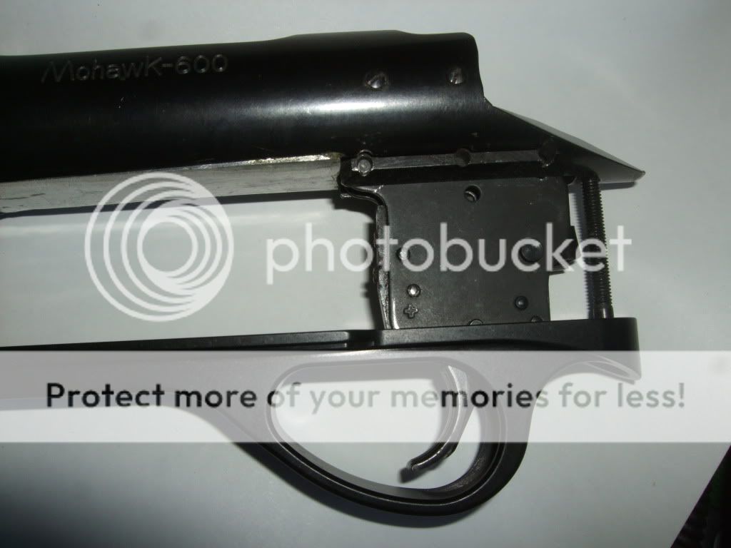

I cut the trigger off of a 700 and repositioned it forward so it would clear the trigger guard in my almost completed 600 Mohawk..
I have that trigger breaking very nice at 2 1/2 pounds....

The rear tang screw on my Mohawk 600 seems to clear the rear of the trigger housing without a problem on the 700 Remington trigger I reworked..

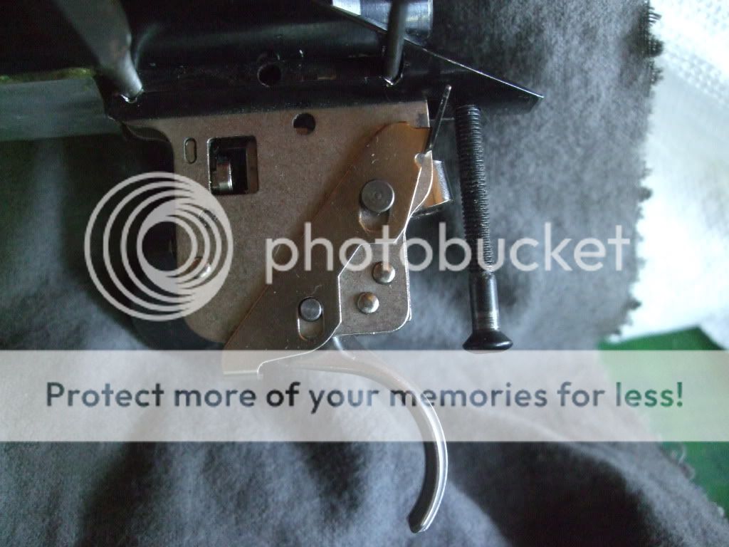

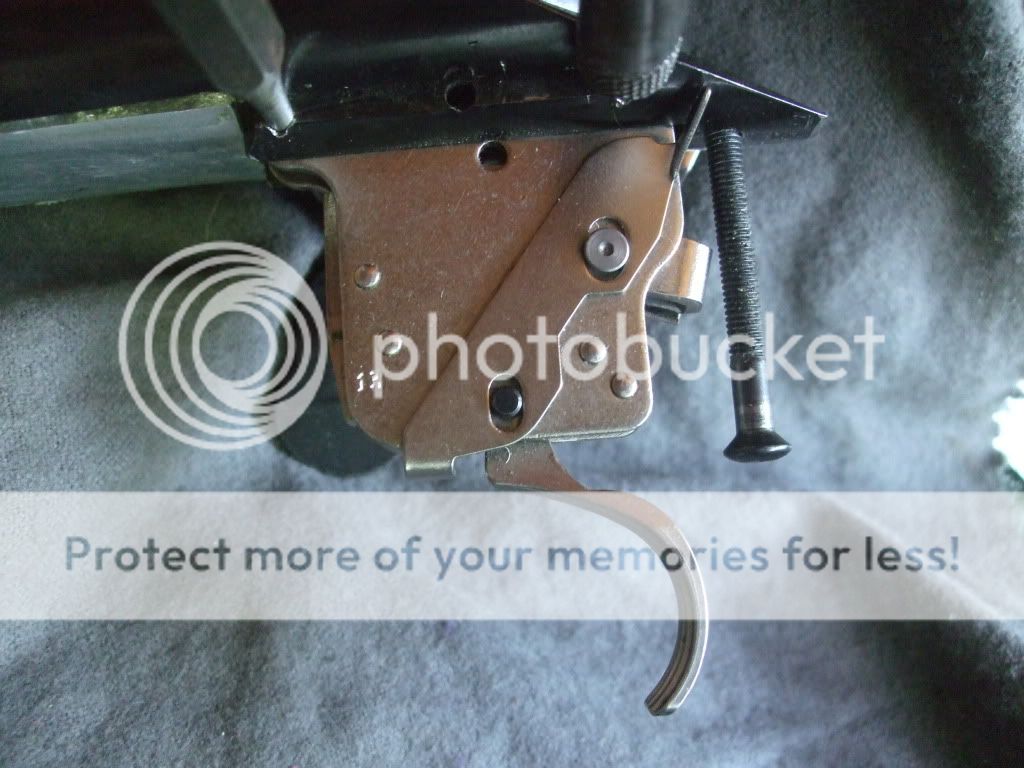

Butch, No sir, it is definitely a 700 trigger that I cut and moved the trigger forward on so it would clear the new trigger guard housing. It is a older trigger that I used...and the first photo shows it setting on top of another 700 trigger that has not had the trigger cut and moved...

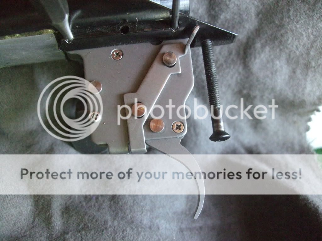

Here's a Jewell in the same 600 but the trigger is to far back to clear the trigger guard, but the rear action screw still clears..

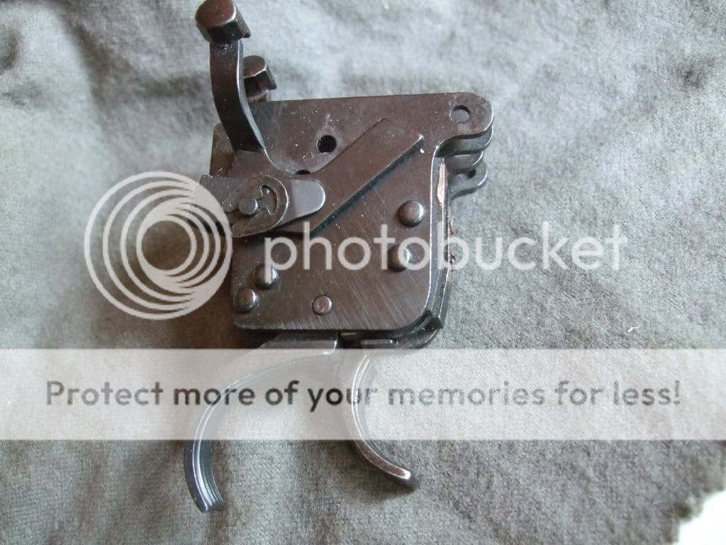

A newer 700 SS trigger still clears the rear action screw, but the trigger is still to far back...
A different 700 SS trigger, but it has the same problem with the trigger to far back, but the rear action screw still clears.

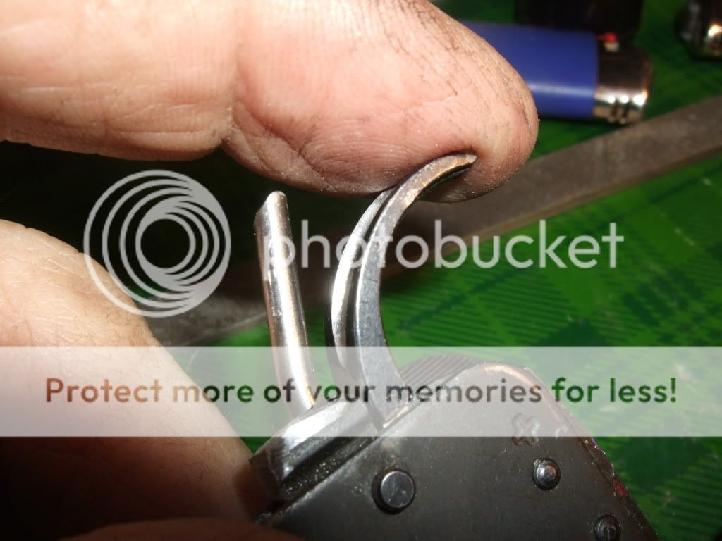

Good pictures. Can you take one of the 600 trigger so I can see where you reattached the trigger shoe.
PLEASE :)
What did you use to attach the trigger to the trigger (stud)?
How do you have room for a pillar on the tang when you are bedding? I didn't have room for one on mine with the 700 trigger.
Butch
The rear pillar had to be halfway notched out a lot for clearance Butch.
Here's the trigger before I silver soldered it together, the trigger sets up against the rod that is drilled into the base of the trigger, not as low as seen in the photo...
