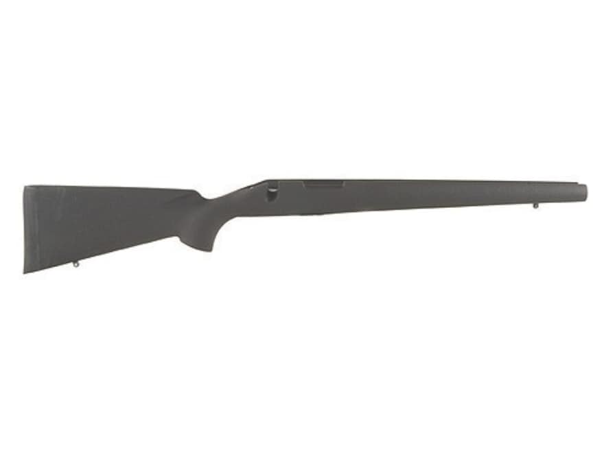

I have done a couple 96% inlets from Richards. I was pretty happy with the results but, it took some work. If you don't mind taking your time and you are happy with the styles they have, give it a try.
One of the stocks I did was for an Anschutz 54 BR rifle. I bought a 2nd in, I believe it was, their "semi fancy" walnut and I was very happy with the wood. It was a 2 1/2" width and I wanted a 3" so I had to add aluminum rails to get the width I wanted but, it was a fun project. The other was just a laminated stock and it was pretty easy to fit and finish.
They aren't crazy expensive so, even if you mess something up, you aren't out a ton of money.
Thanks since the gun is not original it does not have to be like the original. I was thinking about their benchrest stock and they will put a 1 1/4 in channel that would work I love the look of walnut or maple but the laminate would be more stable. I don't shoot competition just shoot with friends the original style stock would look ok also. I am getting older didn't know if the bench rest stock would add too much weight the gun is pretty heavy with that bbl. Might have to build a dolly for it. I'm so thrilled with the gun having a ball with it.
Sometimes originals in the RF configuration show up for a decent price. For a while Numrich had them for $50. I should have bought a dozen!
Now they rn about $200.
You could also find a 700 SA BDL varmint Special stock or even an ADL walnut sporter from the 80's or earlier and hog out the barrel channel a little...Brownells sells a took to do it by hand...and it will work fine. Barrel may be a tad longish...

You'll have to open the barrel channel (it's .950).
