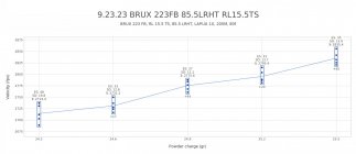

I just had a barrel spun up for some local 3-600yd F-TR matches. Brux 7 twist and used the Manson T15 fullbore chamber.
Took it out yesterday to start a load workup with the 85.5s and RL15.5
I was pretty happy with the initial results but wanted to do a sanity check on my load and velocities. Just stumbled on this thread and am happy to see I'm right there with you with this combo. Haven't tried any seating depth tuning yet I just seat the bullet out as far as I felt comfortable leaving enough bearing surface still in the neck.
