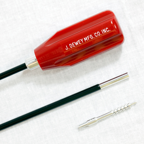

I use Dewey(coated rods) but the end male/female are brass but I ordered their aluminum jags for the calibers that I shoot and so far I haven’t received much false readings like I did with Brass jags. Just a thought and cheaper too.
Me too, your choice, brass or aluminum ferrules (aluminum pictured below). ;)

No sir. The link I posted is for aluminum ended Dewey Rods. When I bought mine they came with aluminum ends and jags. No false positives with this system and cheaper than bore tech.
