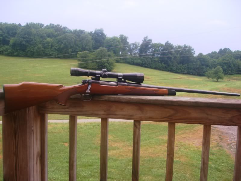

is there a cerakote color that would replicate the color of the deep black looking blueing that was on Colt Pythons ,,I have an A prefix Rem 700 BDL 25-06 I am planning on rebarreling in 6.5x284 with a stainless Krieger bbl and would like the bbled action finished to look like it was dark blued without spending 1,000++ $$$ .

No cerakote will ever look like any type of bluing except the rock blasted remington express type. It will look spray painted.
Watch some videos on rust bluing. Itll get you as close as you can get without extensive knowledge and extensive supplies

Dusty is correct, Cerakote will look like a coating, not bluing. SS can be hot blued, using the proper chemical solution. I'd do an on-line search for a shop that does SS bluing. You could have the barrel black nitride treated. But you need to understand that black nitride is a heat treating process, done by companies that are not metal finishers, they're heat treaters. Gun bluing, be it slow rust or hot caustic is very dependent upon the degree of metal preparation. I've seen lots of metal (firearms) that have been completely butchered because the person who did the metal prep didn't know what they were doing. Corners rounded-off, screw holes dished out, numbers and lettering washed out from buffing. Having the barrel black nitride treated and the receiver slow rust blued with provide a "as close as possible" match in the finishes. But, it will not be "looking like a Colt Python". And, chances are, If you find a shop that runs a set of hot tanks for SS, the color will not match the blue on the carbon steel receiver. It might be close. Your best bet may be to contact Doug Turnbulls' shop and see what he can do for you. Be prepared to pay handsomely for his services...…..

no more than the rifle will be shot maybe I could live with a chrome moly bbl,,as long as it is a match grade and shoots tight,,I thought about having the stainless polished and leave the receiver alone as it is still in very good shape but IDK,,I have had this rifle since 76 and dont really want to alter the look much,,it has taken me about 5 years to decide to switch calibers,,no good 25 cal bullets just sux,,
it`s been close to 10 years since it`s been fired ,the throat is eroded so bad a 100 NBT would reach the lands seated at about 4 inches,,,
There is nothing wrong with a CM, except extra care should be taken to prevent corrosion in the bore. I have seem many (many!) that the owner claimed to have give meticulous care to that were heavily pitted in the bore. All it takes is to leave the rifle set for a day after shooting and the pitting begins, seriously. If you do go all CM , www.gunbluing.com does a very good, professional job.

Cerakote offers a gloss black in h-series that will look as good as cerakote can get compared to blue. The tungsten color is a good looking choice that will hide hard use a little longer. Dlc or nitrocarburizing is a good alternative if you have tight tolerances. It’s recommended to do the bolt body in cerakote microslick. Do the inside of receiver in microslick if the bolt is tight. H-series holds up better than the room temp stuff. There’s huge selection of colors, unlimited patterns and then you get to the guncandy additives. Or, Turnbull does the best blueing.
