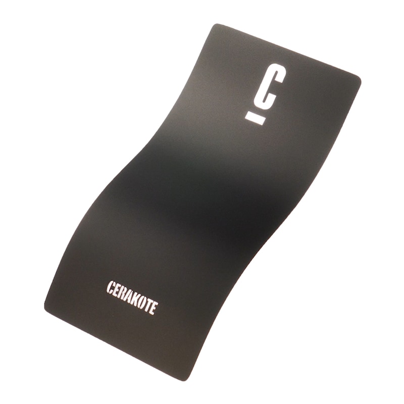

This is graphite black

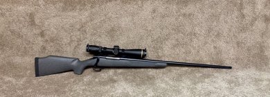

I guess it depends what your take on traditional is, an old Sako or Styer's bluing is probably gonne be a little more shiny then say a Savage or Rem
