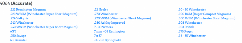

First let me state there are no published loads for the 45/70 using Accurate 4064. Any use of Accurate 4064 is a personal risk and I am not responsible for any using my loads and use at your own risk. I tested the following loads which are published loads all except for Accurate 4064. IMR 4064 which have published loads is almost equal on the burn chart at Accurate 4064. That said here is the info I have measured with a chrono.
