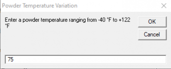

The temperature adjustment is enabled when you click on the small icon to the right of the Ratio of specific heats.
After you click the icon a temperature adjustment icon will appear above the Apply&Calc button
After you click on the Temperature icon this window will appear
It's entitled Powder Temperature Variation so the software expects you use the powder temperature but in most situations your powder will be the same temperature as the ambient temperature and it's pretty hard to actually measure the temperature of the powder.

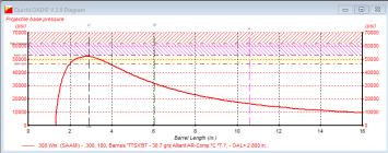

For those who want to estimate gas port pressure (the pressure at the barrel's gas port) take note that you can create a pressure curve that indicates pressure at the base of the bullet rather than chamber pressure (the default pressure).
After you have entered your load data and the software is displaying the results, select the menu item labeled
Change Diagram
Select Optional diagrams​
A window opens that allows you to select all kinds of options for the graphical display.
For port pressure estimates I select
X Axis - Barrel Length (in)
Y Axis - Projectile Base Pressure (psi)
Apply and Exit
The graph will look something like this
This is a load I use in my short barreled rifles for hunting elk
If you drag your cursor along the pressure line, you will see the values appear and change as you drag the cursor.

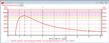

In this case, if my gas port was positioned 2.25 inches short of the muzzle (on a 16.25 inch barrel) I'd have about 11,451 PSI of gas pressure at the port. In my M1A SOCOM you can have a port pressure of about 10,000 PSI plus or minus 2,000 PSI so this is close to the maximum but I've had no problems with the load so far and it works well out of my AR .308 which I use for hunting more often than the SOCOM.
Most people refer to the muzzle pressure as a general guideline for the port pressure but in this case the muzzle pressure is estimated to be around 9,471 PSI, lower than the low end of the port pressure range so you might be tempted to increase the load pressure which would result in even higher port pressure.
P.S. I made several mistakes trying to explain this and this is the correct edited version of my post. The second image shows a 16.25 inch barrel and the proper port position is 2.25 inches from the muzzle. The pressures are the correct values.
