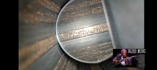

Well first, I am what the Army doctors termed as “Shade Blind”. So I don’t see things the same way that others see them. To me, I see a big improvement from your first photo to the second. There may be some cracking and signs of having lots of rounds down the pipe, but I think you have done a good job of removing the carbon and copper from your barrel. JMHO
Ya, I always brush after initial patching. The abrasives are basically an unknown for me. I've only done it once to an F-TR barrel that I only half arse cleaned thru out the season, and didn't yet have a bore scope. I remember that the patches following came out grey for hours! I don't really know what was going on there. It was JB.

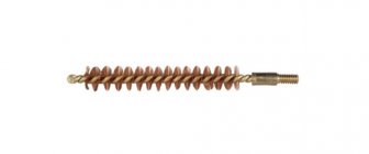

You can substitute JB on bronze brushes for Iosso on their hard nylon brushes. Usually takes a couple of applications of JB vs one for Iosso.
Im saying a bronze brush used at every cleaning with a good solvent will prevent this. Now that you have a build up jb will probably be needed. I use one size smaller nylon brush with a patch around it to jb.

Yep, been scrubbing solvent with bronze after every range session, or match all my life. Hawkeye still shows a little carbon (and sometimes a bit of copper) about 3" ahead of the throat. That's what I want to work on.
I wonder if that is some crud that is welded on there from years ago, when clean patches used to fool me.

Bore scope, where is is? You may have verified your process already, and I apologize if that is the case.
Bronze bristle brushes, buy in bulk, use 50 strokes, then use the brush with patch/JB or ? on it, throw away often. We need a vendor to sell bronze bristle brushes in 120 count boxes.

Bottom line, Brushes are over used. Change brushes often, use lemon water or Kerosene. For plastic Brush users, check the Coefficient of Friction of plastic on steel in the machinist manual...get ready for a shock.
I was cleaning one last night kinda regular deal on good barrel, penatrating oil; carb-out; accelerator wipe-out; naphtha in between; all this on patches and stroked some. Thought it was perfectly clean and decided to pull out the Teslong. Nope some serious copper streaks on a few of the lands. AckleymanII is right, don’t skip the brush. Went back and did this and patches with Wipe-out and Accelerator, could have painted a golf ball blue!
