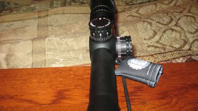

I have three,my 12-42x just came in yesterday) NXS scopes, all with windage turret caps that look like this: NXS Windage Turret
Trust me, I *wish* they came w/ 0-9 rather than 0-5-0... maybe its an option and I can order new caps from NF? Guess its worth checking. I ordered the first two, the 3.5-15x50 and the 5.5-22x50 last winter right before the price hike, and this one as mentioned just got here. Maybe yours are earlier production models?
Edited to add: I talked w/ the other guys I shoot with... theirs are all 0-9 as well, purchased both before and after mine. Wonder how I got 'lucky' on three separate occasions? There has to be someone else out there w/ the 0-5-0 turrets, right???
