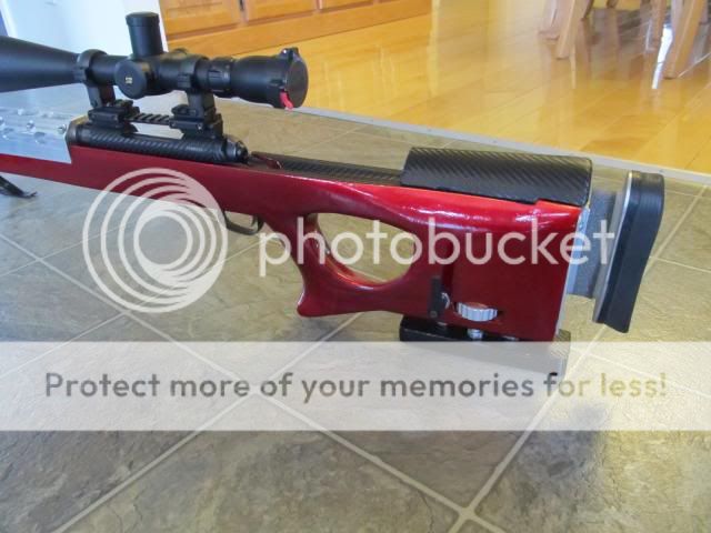

Here is my solution
Jerry

@mysticplayer, That is a HOT looking stock! I constructed a bag rider last night for my stock. Turned out pretty nice... Not as nice as yours, with its elevation adjustment and all. Did you vinyl wrap your action?

Isn't that illegal?
Here is my solution
Jerry

Jerry - I am pretty sure by the F/TR rules - your adjustable stock is not allowed. It is in F-open.

I thought I remembered reading that mechanically adjustable bag riders or rear bags were illegal for FT/R. Did want to bring it up and start the legal debate.

the rule states that no adjustable support is allowed. the stock is not "support" it is what is being supported.
NRA rule
No portion of the rifle
s butt or forend shall rest directly on the ground
or any hard surface. A rear
rabbit eared bag, small sandbag or a gloved hand ma
y be used to support the rifle
s butt. Any rear
support employed shall not be attached, clamped or
held to the rifle in any manner. The rear support
may not be fixed to or protrude into the firing poi
nt. Mechanically adjustable rear support is not allowed.
