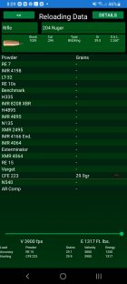

30g of BLC-2 and a CCi 450 will get you real close with a 39g SBK. Works fantastic in my CZ 527 Varmint. My realized velocity was much different than this chart (3850fps) as every rifle is different.
