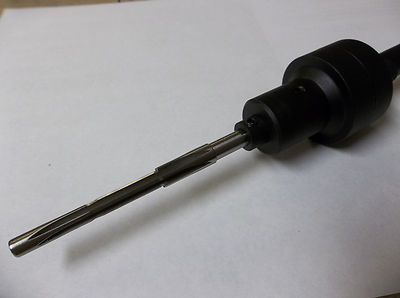

Where does one get the adapter? Something manson has on the shelf as well?
Nope, Manson doesn't offer them (maybe they should...)
Ebay:
I don't have a reamer to get a good sliding fit for the 1/4" throaters which is why I didn't just make one.
The adapter is well made with a good sliding fit, and cheap enough.
Uni-throater is nice, but geared for those that don't have a lathe and need to run the reamer by hand. No reason for the extra expense when you've got the machinery...
Ebay:
I need to make one of those. Wish i had a nice .250 reamer to put a good hole in it
Need a tool make a tool. I ordered one because they're cheap but will make one and just lap it to be exact.

They're called barrel laps. But not the kind of "barrel" we're talking about here. These are for honing the ID hole.
