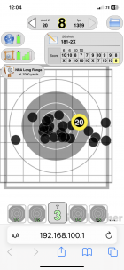

I’ve conducted a similar test a few weeks ago, but from an AR. Not much difference on target but can see a slight difference on chrono.
