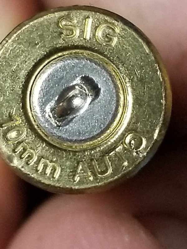

I know of a baby 10mm glock that has swipes on it just like the OP and it has probably 2000rds on it with no breakage. Guess the shape of the glock pin probably helps it to not break.

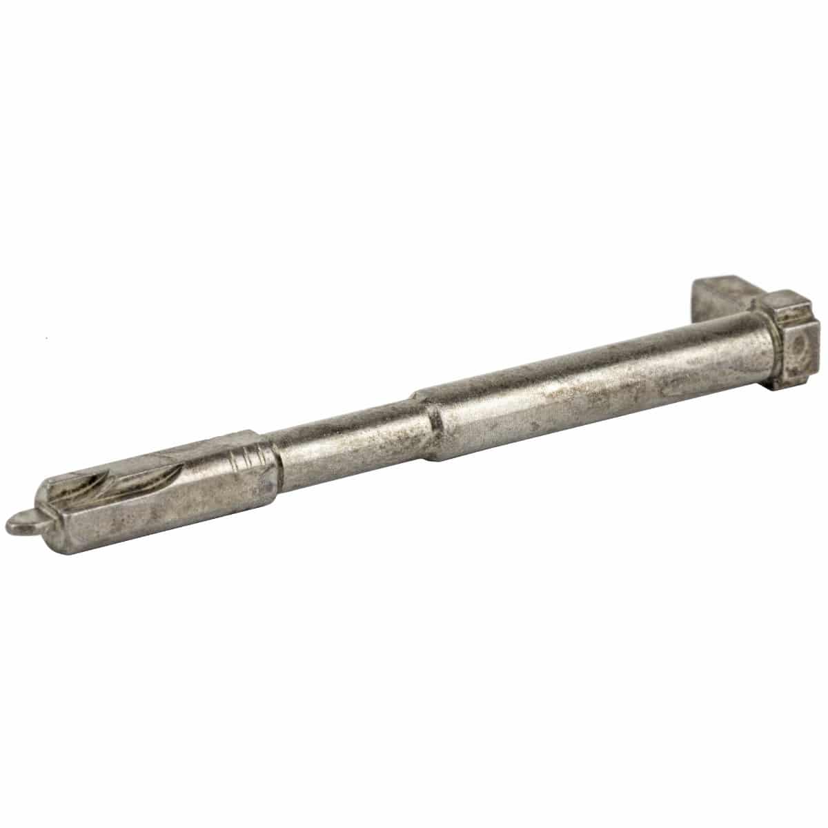

Glock OEM 10mm and .45acp striker below, its strength comes from being elongated and not shaped like a pin.
I have the same marks on my Glock 22 .40 S&W as the Glock 10mm below.
