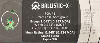

I got a Garmin chrono for Xmas and since it is much smaller than the old Labradar, I am taking it to the range for every session. I shot 63 shots of Lapua SLR with a box speed of 334m/s (1095.8 fps) in today's 50/100 yard Dewar match. The 63 shots had an average velocity of 1060.1 fps, an ES of 41.4 fps, and a SD of 9.2 fps. It is helping me determine whether an errant shot is my technique, a missed wind call or the ammo. In this case I knew right away that the three shots that weren't X's were variations in muzzle velocity. 2 of those 3 were also due to my failure to recognize a further sight adjustment need.
Now I need to figure out whether the ES is really the ammo, or inconsistent ignition. I am the 4th owner of this Calfee built Turbo Mk 1, and from the gunk I cleaned from the bolt internals on receipt, I suspect it has the original firing pin spring.
Ahh rimfire! If only we could know the shot velocity before releasing it!

Knowing the next round's velocity doesn't mean it's POI can be predicted. Wind aside, rounds don't always go where the MV says it ought to go.
Unfortunately, the app stripped out the tongue in cheek emoji after the sentence you quoted.
That said, in this limited run of data the correspondence of muzzle velocity to vertical placement on the target was very pronounced at 100 yards. It is something I will look at further in our Dewar & Mini Palma matches through the coming season.
I will be interested to see the ES & SD for the same lot of ammo in the other rifles I rotate through those competitions.
