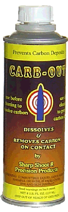

2015carbout 2
For hard carbon ( carbon ring ) I take this stuff, soak a patch, and wrap it around a bronze brush, then let it sit inserted on the carbon ring overnight. In the morning a few twists of the rod then push it through the barrel. Clean things up and give it a look with the Hawkeye. It has worked every time so far.

I read that there is no solvent that dissolves carbon. Maybe the cleaner loosens it up because it isn't pure carbon but a mixture of chemicals.

Google told me this:
What solvent will dissolve carbon?
“As others have noted, it is not soluble in anything at room temperature. if you REALLY insist and want to dissolve it, or any carbon compound, it will dissolve in liquid iron.”
now I gotta find some liquid iron.
