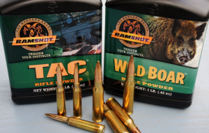

Powder substitution
TAC and Wild Boar produce very high MVs in .308. Wild Boar suits .223 with 75-80gn bullets.
I said in that (10-year old) Targetsports feature that Western's Accurate 2520 and our Europe-only Ramshot Wild Boar appear to be the same thing based on identical published loads tables right down to a single psi pressure, but also US retailed ('Accurate-2520') bottles labelled as 'Made in Belgium'.
Since then, I've been assured by US based Accurate Shooter Forum members that the latter has changed to 'Made in the USA' and their enquiries to Western confirmed this. It seems that Western Powder Co. switched procurement to General Dynamics' plant in St. Marks, Florida which also produces Hodgdon's 'spherical' powders, Winchester grades, and more recently Alliant's 'Power-Pro' grades. This would make all 'Accurate' brand 'ball' powders also St. Marks products these days, but it seems that 2520 and Wild Boar continue to use similar charges for similar results. Ramshot brand powders in the US currently continue to be sourced from Eurenco P B Clermont in Belgium, and of course Accurate / Ramshot have recently joined the Hodgdon products stable. Whether that brand ownership change also results in a switch to St. Marks we'll have to see.
I'll rerun (Belgian) X-Terminator, TAC, Wild Boar, and Big Game range-tests in a long-throat / fast twist 223 Rem F-Class rifle later this year with the 77gn SMK and alongside some other ball grades in an ongoing search for viable VarGet and H4895 alternatives. TAC is certainly an excellent alternative to the Hodgdon pair. These days, I mostly use it in 6.5 Grendel which it is very well suited to.
