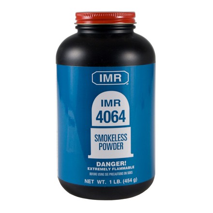

Shooters world precision rifle, which Laurie references in his Reach articles, has been showing promise for me in replacement of Varget, and seems to have decent availability. IMR 4064 is tough to beat as a versatile powder unless you absolutely must have temp stability.

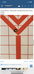

I often wondered what Big Game would do with the 105 type bullets in the 6BR Norma. I t falls pretty close to N140 on the burn chart.
