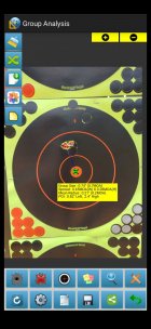

I probably wont be hunting with this load. It was some loads I made up for a buddy who just target shoots. I grabbed a box for today's range session. 168 Accubonds with IMR4895 were unimpressive. I have some TGKs, Lehigh CCs and some Hornady SSTs still to test. But the SMKs shows what the rifle is capable of.
I got some factory Federal Premium 165s to test a baseline and they shot very unimpressive groups as well.
Caliber308
RifleRuger SFAR
Bullet168 Grain Accubond
PowderIMR4895
PrimerCCI 200
CaseNorma
COAL2.800
Powder ChargeAverage VelocityESSDGroup MOA
40.02466 (Test Seat Depth)
17​
6​
1.84​
40.52467
54​
26​
1.39​
41.02478
65​
24​
1.55​
41.52542 (Pressure Signs)
48​
19​
2.49​
42.02542 (Pressure Signs)
57​
22​
2.93​
