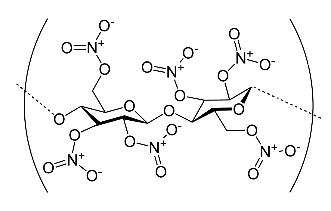

A peek at a chemical formula for nitrocellulose shows the chemical nitrogen present from reaction with nitric acid, HNO3. The reaction formula is present along with chemical formulae and molecular structures of nitrocellulose on Wikipedia for one such spot.
Similar with nitroglycerin

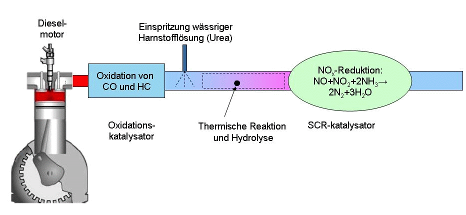

It has a macro scale cousin FGR, Flue Gas Recirculation, on industrial furnaces such as at refineries and petrochemical plants, electric power plants, etc. Plus catalytic converters just for NOX emissions called SCR (Selective Catalytic Reduction).
So athough diatomic nitrogen is viewed by many as inert, every day when we take simple actions such as use vehicles with internal combustion engines, and build fires in BBQ pits & grills, fireplaces, and firepits, we wind up burning atmospheric nitrogen in the atmosphere to NOX. So it's not all that difficult to render diatomic nitrogen gas to react. Nitrogen is abundant especially compared to the noble gases and is relatively easily separated and concentrated from our atmosphere for further use.

Scr (as pertains to on road diesels) I find relatively easy to live with. Aside from the inevitable exhaust leaks and NOx sensors going wonky it's been livable. EGR on the other hand has got to be the worst thing you could saddle and engine with. Plugged coolers, increased cooling system loads, carbon packing pistons breaking rings and sucking oil... The new Duramax 3.0L (and the Caterpillar C15 before they bailed the on road market) has at least a less offensive method where they pull exhaust from downstream of the particulate filter.
The ag sector Case tractors use SCR only, no EGR, no dpf, no vgt. Just an engine as Rudolf intended. Of course, their NOx standards likely aren't as stringent as the on road segment. The engine is much happier.
