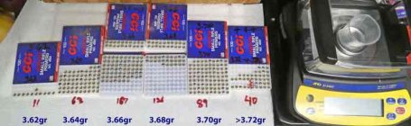

Use my EJ54D2 for powder, primers, bullets, and cases.
Weight range of CCI450 3.615grains to 3.755grains.
Ran it on the self contained battery, on the stove to sort primers then 200 cases and 200 Berger 85.5.
Still showed full bars. Have no idea how long it will run on one charge.

Sorted primers to 0.02 grains, used the 3.66gr ones this time, maybe the 3.64gr ones next time.
