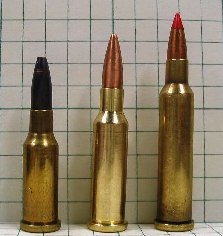

I use 1.8gr IMR700X for about 2000fps in a case with 12.75gr H2O capacity. The 17hornet is about 14.5gr H2O case capacity, and the squirrel has about 8.6 to 9.0gr H20 case capacity.
I would suggest that you use a .17squirrel, the round on the left. In the photobucket link. The reamers are available as are the dies. You will save yourself about $600 if you just use a 17hornet, the dies are cheap, you may not find the accuracy though it will be easily sold if you are disappointed. Then again you may have already accomplished your goals.
http://i51.photobucket.com/albums/f388/glwenzl/IMG_0067.jpg
http://www.saubier.com/smallcaliber/17squirrel.pdf
