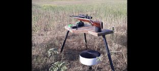

I just bought the legacy shooting bench, same one as in your picture. Doesn't get more stable!!!
I made another bench similar to your legacy one and it sure feels good to be able to get square and hunkered down behind the rifle. Hopefully I will be able to better see my hits now. I made mine extra wide as I am a wide body model. It is heavy probably 60 lbs easy so might route some handholds on each side. Cant wait to get it in the field but it is storming.

I have that same bench(Legacy Shooting Products)with the 4 adjustable legs.Very well made,legs store in the underside and has a handle cutout for easy carrying,and price won't break the bank.I like mine a lot.
Same here. Great bench if you can find one.
