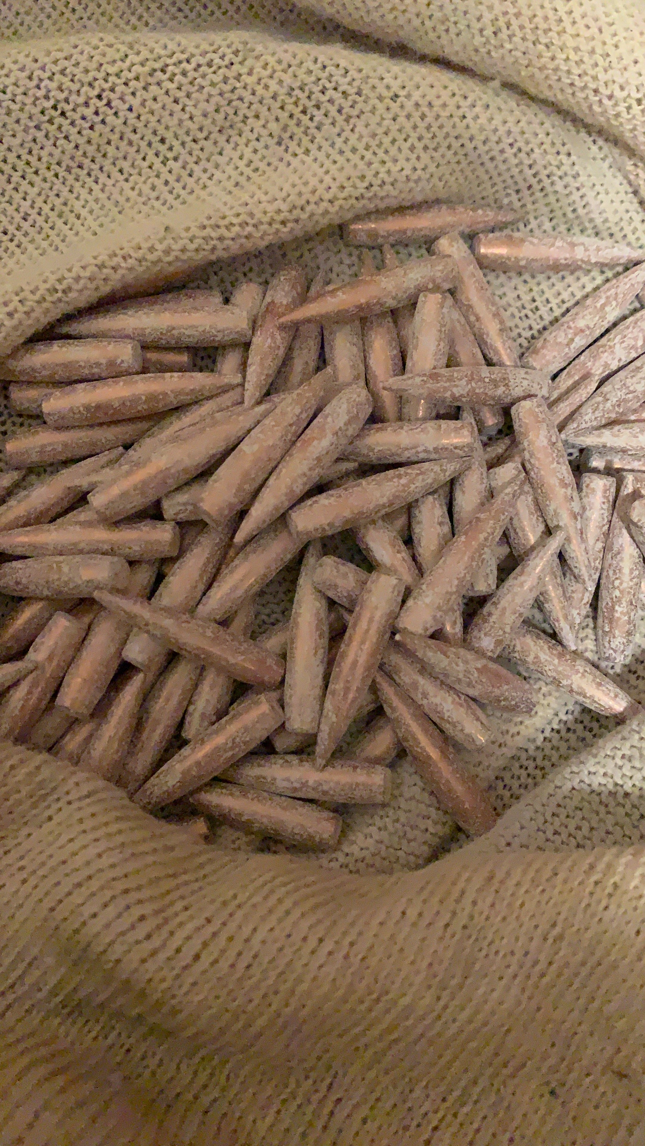

As they come out of the vibrator
After a bit of shaking around

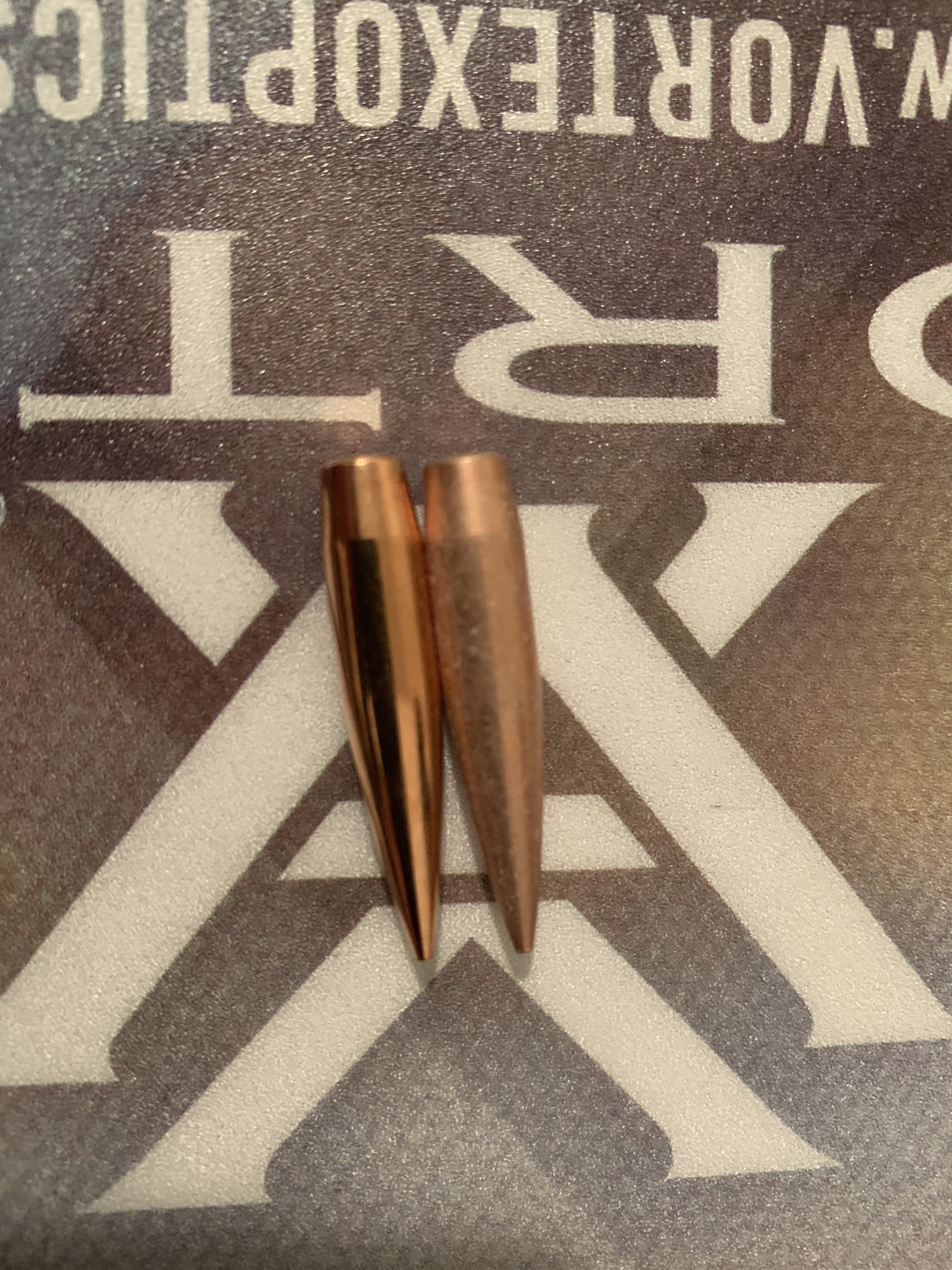

Before and after treating
