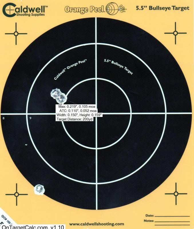

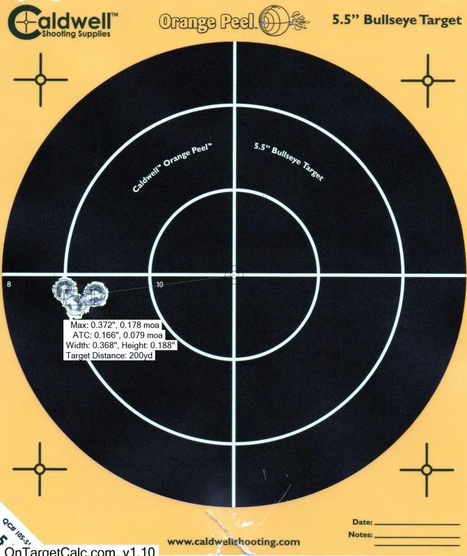

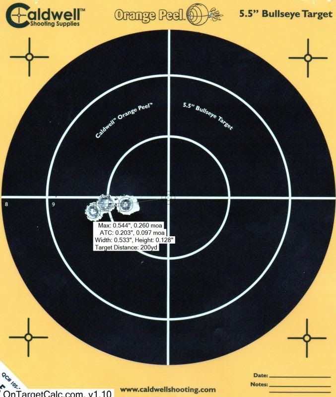

Well I got my bolt back from Greg and went out to the range to test some 28.0gr and 28.9gr of Varget. I wasn't really prepared but I will end up re-shooting these. I only had one sighter and didn't have my scope adjusted right so I changed it after shooting my first three targets. I had 5 targets for 28.0 and 28.9. 3 loaded 0.0, 0.10, 0.20, 0.30 and 0.40 off the lands. I shot these round robin again. I will just sort of show the ones worth showing. The mirage was a killer at times, but I think I will work on these two loads. I still want to work up the loads when I was piercing the primers, and hopefully I will if it doesn't get too cold. I will do a 5 shot group hopefully next week ???
28.0gr 0.000 off the lands (the 1st shot was my sighter and I adjusted my scope before I shot the last two.
28.0gr 0.030 off the lands
28.0gr 0.040 off the lands
Well compared to the primers I shot last Thursday, today seems like the primers were smoother when running your finger tips over them. I'm curious to see when I try loading up some 30.5gr of Varget for next week.
