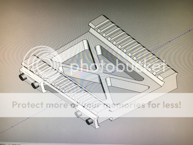

Looks really good but any reason for the hex screws and not a 7/16 or 1/2" nut like is on most Pic rings. Guess it doesn't matter but since u will have socket/wrench out for the other scope rings, just seems simple (and maybe slightly easier, unless harder to construct).
Y'all asked for it ......
So here it is.

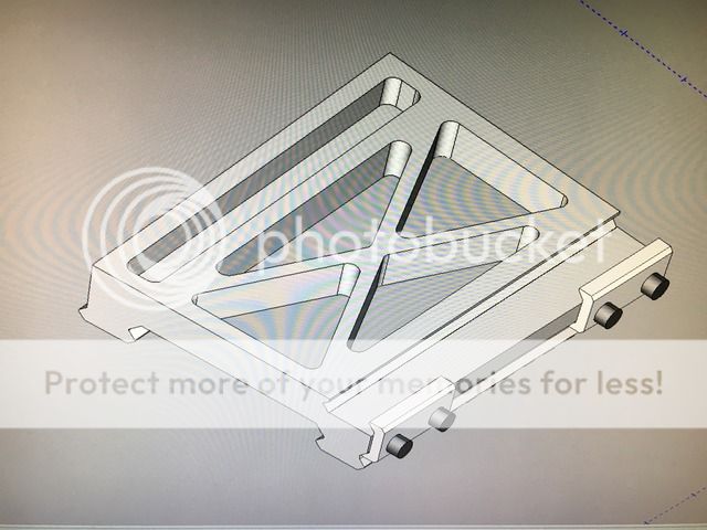

I don't know the actual weight yet. My goal is to have this come in at or below 13 ounces.
Features:
Black Anodized Aluminum Body
Stainless Clamps
10-32 screws
HeliCoil thread inserts
Price = $195.00 (and that includes shipping to any US address)
After reading the post by Alex and being suspicious of my scope I did the same as you. Here's what I ended up with. The plate is 6.82" X 4.50" with the body being 5/8" thick. My intent was make it universal to a long/short action rail. It did come in @ 2lbs, not sure 13 oz. is do able.

I might suggest that you make it a dual- purpose test stand. Add a dovetail opposite the weaver mount. Then it would fit Panda and other actions.
You could turn the test stand the other way so that the test scope is still on the desired side.
That is a good idea. And if you have an assortment of Picatinny and Kelbly style rings in your inventory you'd have a versatile piece of equipment.
I feel that most shooters that would want what I designed, probably don't own any Kelbly style scope rings.
On the contrary, I am looking to purchase and I havea 2 pandas and 1 borden with a dovetail mount, my only Pic rail is on my heavies. I believe there are more people especially benchrest group or score shooters to test their scope before a big match that want this with dovetail mount on thier actions. Can you make this happen?

So what do y'all think about a base that would attach to a PICATINNY rail or 3/8" DOVETAIL base on your rifle?
Obviously you'd need to use Picatinny Rings on the scopes.
I haven't ran any yet.
I can add this feature to my design.
I've been kicking that idea around for a while now. My reasoning for not offering it with both on the bottom is the inertia of this much weight, plus two scopes, on a heavier recoiling rifle. Most guns with a Davidson style rail fall into a BR category and most(not all) will be small caliber and heavy guns. I feel much safer going this route, myself.
Before agreeing to make these, I asked Charlie Hood for his blessing, first. I didn't want to step on his toes by offering a product that is his design without speaking directly to him first. He agreed and I am making them. I'll be shipping the first ones out early to mid next week.
In speaking with Charlie, the point about inertia came up. Jim Borden ran the numbers for Charlie and determined it a real possibility that base screws can fail under the amount of force generated by the recoil of a rifle with enough recoil energy. Of course there are several factors involved here. Caliber, gun weight, screw size..etc. Bottom line, I decided to err on the side of caution, to the best of my ability. I understand this leaves some people feeling left out or whatever. Believe me, that is not my intent and I wish Dennis well in making his Picatinny version. Rather than me making the pic version, I'm content with Dennis making them. But, as you mentioned, adding a female pic rail on the opposite side of the dovetail is very doable.
