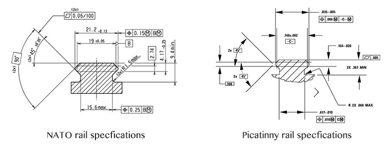

I'm posting to ask a question about the way different scope rings mount to a pic rail. Attached is sketch of the cross section of a rail. The dimensions/tolerances are from the 1913 standard. My question is this - The way the rail is toleranced indicates to me that the ring base should make contact on the angles (yellow), yet many designs make contact on the top of the rail (orange). The yellow surfaces are controlled with the .748 +/- .002 dimension, while the top can be as much as .02 under and still be in spec.
In your experience, does it matter?

Anybody else want to chime in? I know it's kind of trivial, but it appeals to my OCD side that the center of the ring doesn't shift based on the rail height if you use the contact surfaces in yellow.
Getting ready to make a one piece mount soon and ran into this while designing it.

Worth looking up the standards, as there are a couple that address this exact question. Picatinny uses side clamping, and then is a bit fuzzy about how it interfaces with the crosscuts so is only sorta truly as specified.
The (very similar, broadly backwards compatible) NATO RailGrabber improves on this by being a three point of contact system, uses the top rail as one specified part, and more surface area, I hear, but now we're at the edge of my understanding of why that's all good.
shoobe01 - Thank you! I had the 1913 standard but was completely unaware of the NATO spec. This was the information I was looking for with my original post. It looks like they cut the tolerance from the bottom angle to the top surface in half to better accommodate that style of mounting.
