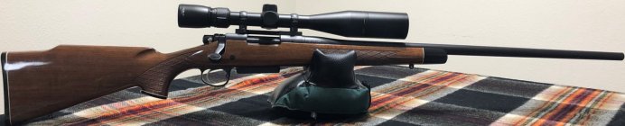

I have a remington 788 26” 11tw krieger mtu/ mcmillan hbr stock, timney trigger. Nikon (japan) 6.5-20 fch. I have only had time to shoot it with H4198 and 32’s. Vmax and Blitzking. Its absolutely surgical on varmints. Very fun very easy. Tiny clusters no problem. Im shooting 20.5 grs H4198 and probably will until i cant get it anymore. Id like to try A2230 &VVn133 but havent had time. Love the cartridge

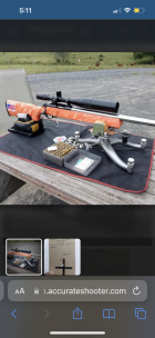

I loaded up some off the 23.5gns 2207 with the 32gn vmax
I thought id see what it did over the Magna speed spotter chronograph
The 2 shots I fired went 4004fps 4005fps
Is this possible or is that telling me lies don’t have another chronograph close handy to verify until a mate comes with his
