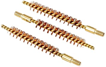

Nobody has showed me anything that will remove carbon without mechanical action. Least damaging is a bronze brush. Its just like the ar500 crow i carry around for those 800yd deer killers to shoot at- i have a hawkeye that tattletales. There are plenty of products that work on copper, but carbon is a whole different animal

From my tests this bronze brush gets the all the practical carbon and copper that's not hard burned on. I have been using Eliminator as lubricant for the brush, and simply ignoring the blue (know that it works and I ignore the color from the brush). I skip the patching Eliminator step to start all together. Its redundant. The Eliminator and brush gets all the copper.

I've heard from numerous people that should know that nylon brushes are preferable to bronze.
Some of the copper cleaners even specifically say not to use bronze brushes
I cant think of anybody that knows that would recommend nylon over bronze- and i know some heavy hitters. You have to neutralize the bronze brush after you use it. I use carb cleaner or dip it in a bottle of water. They wont last long at all if you dont.

Know some people that went down that road (including myself years back). Most all ended back on real brushes.
For certain aspects and applications, plastic brushes have there place and merit. But for "in general barrel cleaning" there's nothing that can get hard and/or layered fouling out any better or as effective then a bronze brush can that I've ever seen or used.

What is the place for a nylon brush? I havent found it yet
Boretech instructions say to use a nylon brush after the initial 3-4 wet patches when using either their carbon and copper solvents.
I use a bronze brush straight after a match to get at the carbon, then go to the first few wet patches.
Bronze vs. Nylon brushes - a little common sense may be useful here if we're talking about the superiority of removing carbon - it stands to reason that the mechanical action of a bronze brush would be superior to nylon - right?.

Thinking out loud... My question about bronze brushes has to do with their comparatively much higher level of abrasion as compared to a carbon fiber rod brushing against the rifling such that people will mock and ridicule you if you don't use a bore guide with your Cleaning rod.
Bronze brushes are significantly more abrasive then a carbon fiber rod barely grazing the inside of the bore.
Hey… I use a bore guide. To minimize the abrasion of the cleaning rod. To then use a bronze bristle brush that is far more abrasive? Makes no sense.
