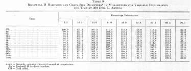

The report has a 300C annealing chart. The chart doesn't give any GS data because at 300C there is no recrystallization even for hours at temp. You’re saying because recrystallization can occur at 550C it must start at 300C. Total nonsense. Your making this stuff up.
Where do you get the necks have 70% cold work. Sounds like sizing a neck and it goes from .013" to 0.0039" thickness. 70% cold work means the thickness is reduced by 70%.
Where do you get the necks have 70% cold work. Sounds like sizing a neck and it goes from .013" to 0.0039" thickness. Daa

The entire report is about 1 MB in it's published form. I pasted just the charts into a word file, it was about 12KB. Cannot attach to a reply.
Yes. Increased CW puts more energy into the metal allowing recrystallization to occur a little sooner.
The charts indicate that any annealing we do is to short of time for recrystallization to occur flash annealing at any temp.
Sometimes a GS number isn't entered in the shortest time column. This is because GS numbers are not assigned to elongated flattened cold worked grains. 15 seconds was the shortest time tested.
From the charts if I can type this up so it makes sense:
300C 70% CR 336 hours no change in GS.
350C 70% CR 2 hours start of a small increase 8 hrs a slight increase in GS.
400C 70% CW 16 minutes the begining of increase. 8 hrs at temp GS went from 0.016 to .017.
450C 70% CW GS starts to increase in 2 minutes.
500C 70%CW GS starts to increase in 30 seconds.
550C 70% CW 15 seconds the beginning of GS increase.
600C at 70% CW 15 seconds the beginning of GS increase.
650C 70%CW 15 seconds GS begins to increase.

Here's the 300C annealing chart. Hardness is related to yield strength and tensile strength. Forget about GS. if the hardness doesn't change the grip on the bullet doesn't change. No GS data on this charge because there is no grain recrystallization even at 336 hours.
Cold working induces stresses in the grains, which increase hardness!! LOOK AT YOUR TABLES!!! %CW from rolling!!!
What caused the drop in hardness then???? RECRYSTALLIZATION of the old grains with no growth!!!! Stress relieving brass!!! Taking the stress out of the FCC lattice, thus reducing the hardness!! The perfect temperature to deform (reshape) without work hardening!! And the long time at 300C, the start of nominal temperature range!!! Looks like from your tables, very slow grain growth starts at 350C!!!
Tensile strength is closely related to hardness!! By the way!!!
