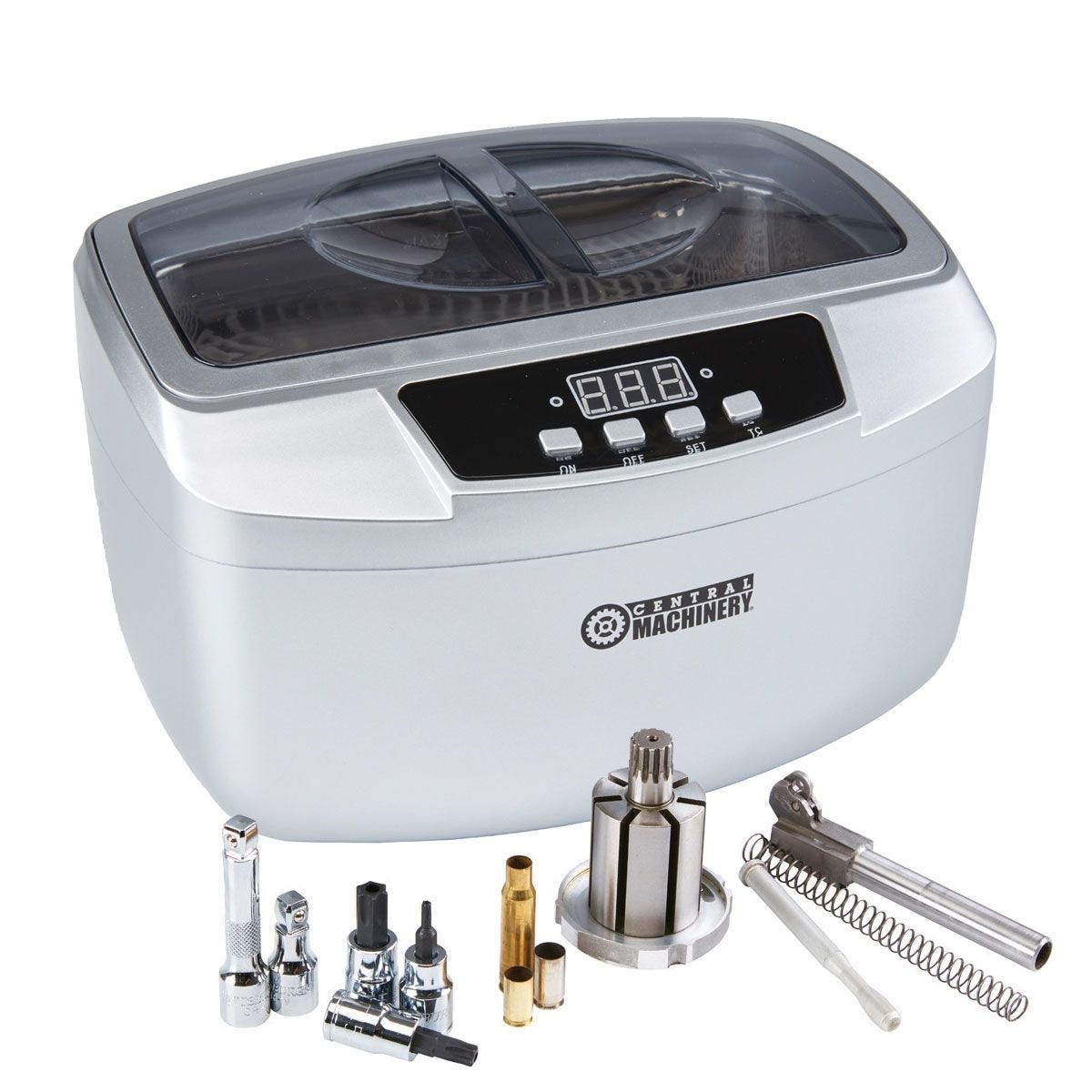

All US cleaners are made in China. I have had this one for 5 years and still going strong.
