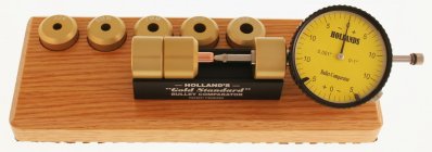

You sorting your bullets by BTO?
What I use......I did change to a wide flat tip to register on the base.
Some bullet bases have a slight concave and will give erratic readings
with a pointed tip. The unit does come with one and find it handy when
checking rim thickness on 22 rimfires.

Exactly how do you measure this distance?
With a comparator insert having a diameter where a light ring mark can be seen at the same place the seating stem does (like, twisting bullet slightly into the seating stem). Take a very small diameter comparator insert and drill out the hole to the size that matches the seating stem contact point. In the instance for my .264 bullets, the 17 calibers insert from Sinclair is a pretty good match for my L.E. Wilson seating die stem. Sorting bullets base to ogive with that insert.
