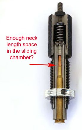

Saw this question raised on another forum and hadn't considered it previously... wondering if any of you have input on this.
The micrometer seating dies from Redding/Forster have a sliding sleeve that fully encases the cartridge so that it is held concentric while the bullet is being seated. This sliding sleeve is cut out just like a rifle chamber with room for the neck and a "freebore" where the bullet rides when being seated. It's designed to index off the shoulder of the case and the spring tension in the die holds it in place while the seating is happening.
Is there enough space in the seating die "chamber" to allow the longer neck to fit? Or is the case going to index off the leading edge of the longer neck?
Is that a problem if it indexes off the end of the neck rather than the case shoulder, given that the only pressure on the case is from the spring?
That sleeve is not hardened and the die can be disassembled sleeve removed and put in the lathe, run new longer neck reamer in, presto....
