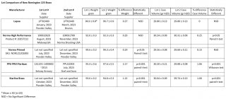

I updated my review of Norma brass after completing more tests with Norma High Performance brass made in Sweden. Two panels from the revised review are below. See full review with revised conclusions at:

Thanks for posting this information on the current Powder Valley website which contradicts what a Powder Valley representative informed me by email in August, 2023. At that time in response to my question on the country of origin and lot number of SKU: NOR121201893 that I purchased, the rep stated, “After reaching out, it looks like the brass is from Norma in Hungary and the primers are from Norma in Germany. Unfortunately, we were unable to get a lot number …..”
At this time, it may be best to characterize the primed Norma brass identified in the graphs as “Norma Hungary Primed” that I studied as “Primed Norma Brass (SKU: NOR121201893)” obtained in July, 2023 from Powder Valley. Without specific clarification from Powder Valley, Inc or Norma Shooting USA, it is reasonable to suggest the possibility that “Primed Norma Brass” purchased in the USA market over time may be sourced from two or more international manufacturing locations.
As indicated in the posts by Ned and others, there can be significant lot-to-lot variation in case weight and volume from the same manufacturer in the same country that may be of importance to precision shooters.

As part of a LARGER STUDY on 223 Rem brass for AR-15 service rifle, I looked at lot-to-lot variations among 5 brands of brass. Lapua and Norma had the smallest lot-to-lot variation compared to PPU and Starline. It provides further support for the practice mentioned by Region Rat and others of managing lot size purchases and examining new lots, even from the same manufacturer if you are concerned about precision shooting. The data further reinforced the perception/opinion that Lapua produces the highest quality brass cases.

I’ve finished up my evaluation of 223 Norma brass as a replacement for Lapua brass in my match bolt-action rifles. Although Norma Primed brass (SKU NOR121201893) had thin case neck walls, 21 cases that were tested held up well to 8 reloadings and 9 firings without development of neck splits or loosening of primer pockets. Both Norma High Performance brass and Norma Primed brass provided excellent performance in loads worked up for 600 yard and 1000 yard bolt-action match rifles.
The REVISED REVIEW contains details and data.
