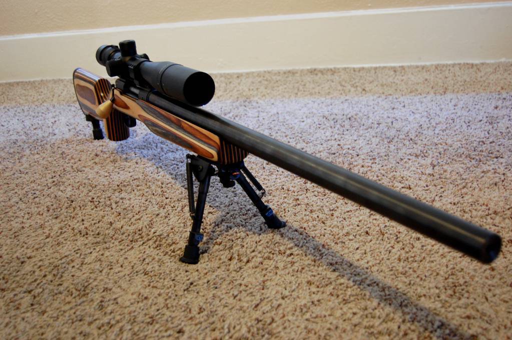

Updated rifle

That's one sweet rifle, and a great topic, CobraRed! I have wanted a heavier barreled varmint- tactical 6.5x55 for years, so recently I started ordering- gathering parts my first custom, and it's going to be chambered in the legendary round. The Bartlein 5R 1-8" twist Sendero contour barrel is already here, and the PTG reamer and uni-throater are ordered. Trying to decide on an action now, there's just so many good options out there right now! Borden Timberline, Defiance Rebel, or a Stiller Predator, it's a tough one!

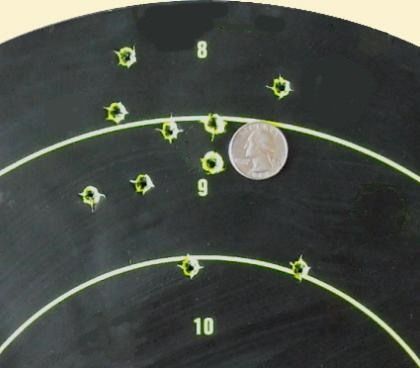

Love my 'modernized' Swede 1917 M96, converted to CG63 in 1978, if that's 'modern' enough?
Here's how it did at 300 yards, iron sights (apertures), 10 rounds (without the bipod, resting on sandbag).
Ammo was Lapua Scenar 139gr over 37gr of VihtaVuori 140, in a recycled FNM case.
