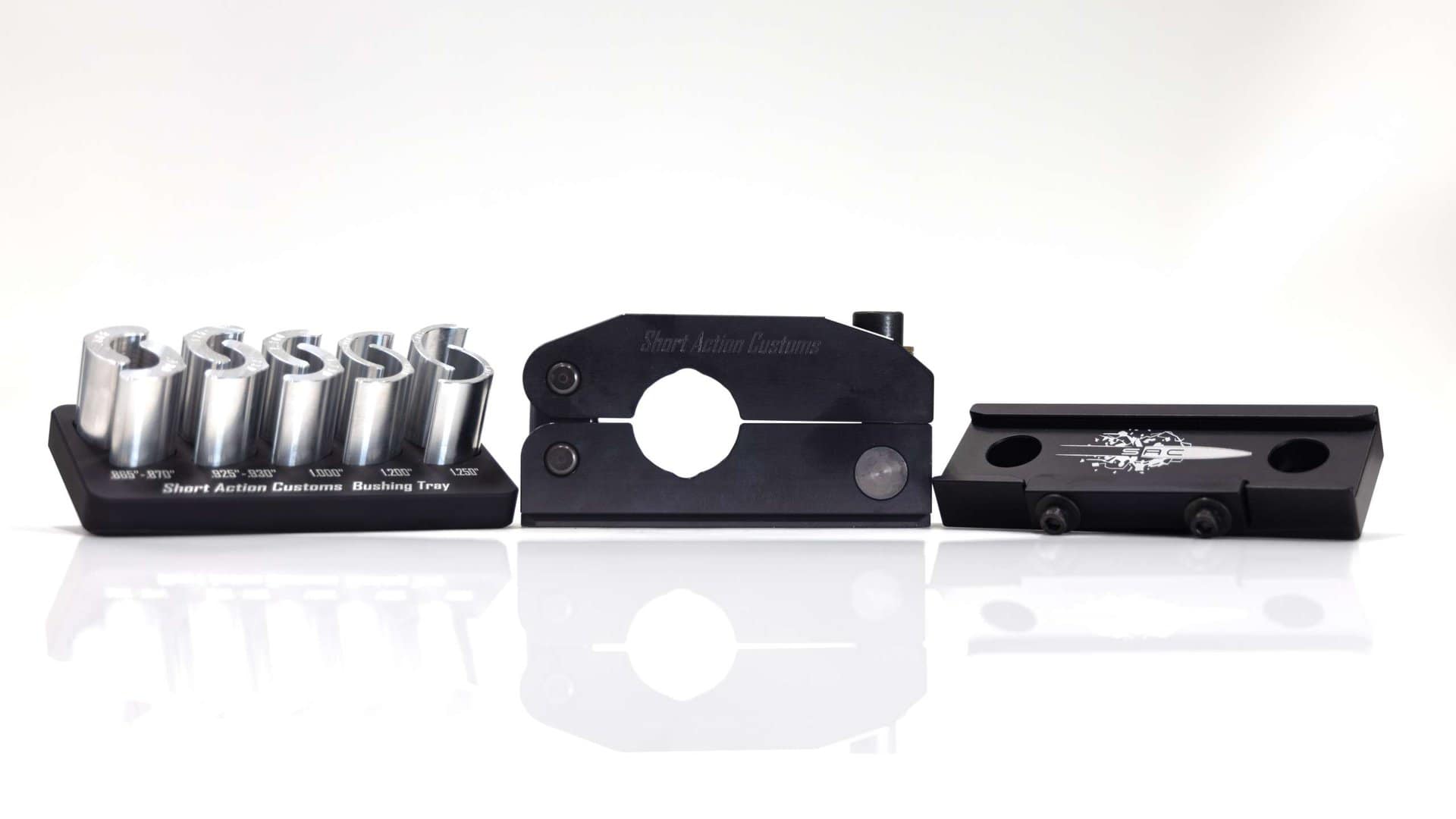

If I go that route vs a action vice how does it keep from marking up my barrel ?
That style barrel vise in my experience always will put some mark on it. You need one with a sleeve to keep from marking the barrel. Here are a few to look at:
I have the last one… good luck!
Haha thanks. But at those prices I’ll put a mark on a barrel lol.

Ive never marked a barrel, not even bead blasted ones, with the 21st century barrel vise
The Davison and Viper will if you tighten them down well…it looks the same design. If Dusty says it won’t, then it won’t and price wise that’s likely your best option.
