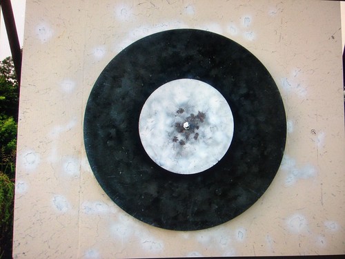

I forgot to mention. This target was shot with the same rifle and the NF scope before the problems developed.
This is the first 15 shot group I fired from 1000 yards with a 6.5x47Lapua after I mounted a 5.5x22x56MM NF scope atop! Since this time....I've had to replace the bolt nut that holds the 20" plate onto the mainframe.....twice! The higher shot toward 11:30 and the two lower shots were before establishing a firm zero.
15shot by Sharps Man, on Flickr
This is the first 15 shot group I fired from 1000 yards with a 6.5x47Lapua after I mounted a 5.5x22x56MM NF scope atop! Since this time....I've had to replace the bolt nut that holds the 20" plate onto the mainframe.....twice! The higher shot toward 11:30 and the two lower shots were after establishing a firm zero.
