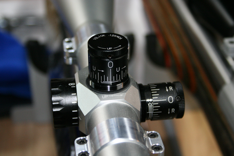

I am looking at one of the Competition models myself and have a question. The pictures shown of them look like capped turrets. What do the look like with the caps off?
A zero stop would be a welcome addition for a scope that only has 5 minutes of elevation adjustment per revolution.
