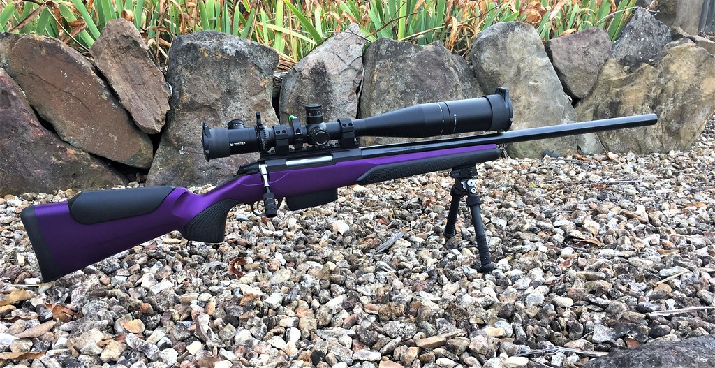

Thanks to GentleBen for the great deal on my newest addiction...er...addition. Tikka T3x Varmint 24" 1/8 .223. Ben had already added the Night Force 0 moa pic rail along with the Mountain Tactical bolt handle and knurled knob. I disassembled and coated the stock in my usual fashion. House of Kolor automotive urethane base in Passion Purple with Cerakote MC-161 matte clear. I added a Magpul pic rail for the Atlas BT-10LW17 bipod. Optic is the Gen 1 Vortex Viper PST 6-24x50 SFP/MOA on Vortex precision low rings. I also added a Lone Star throw lever, Vortex level and Defender flip caps. have a few more things in mind. I'll update as I go.

I like that purple stock. The black accents make the stock with that color.
Let us know how it shoots.
Thanks! Have a few that I've done with the purple and black theme. Those colors just work. Will shoot it and report back tomorrow.

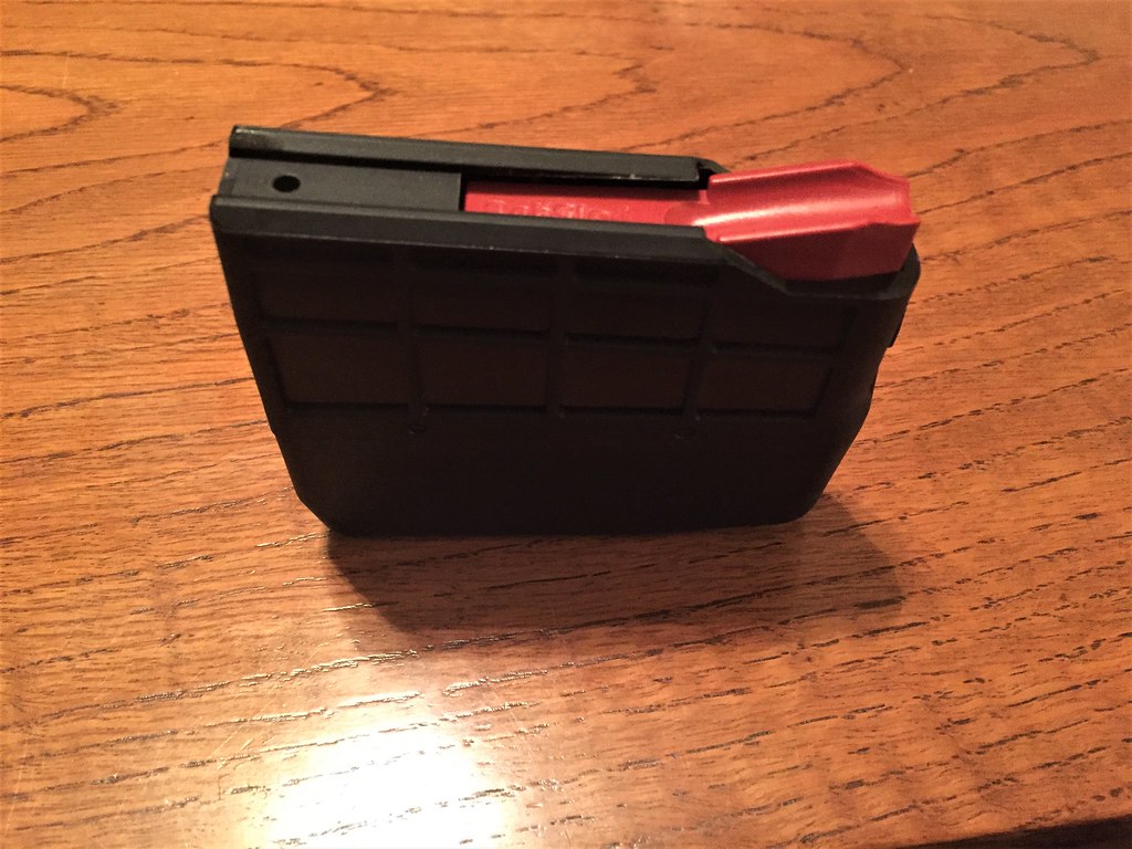

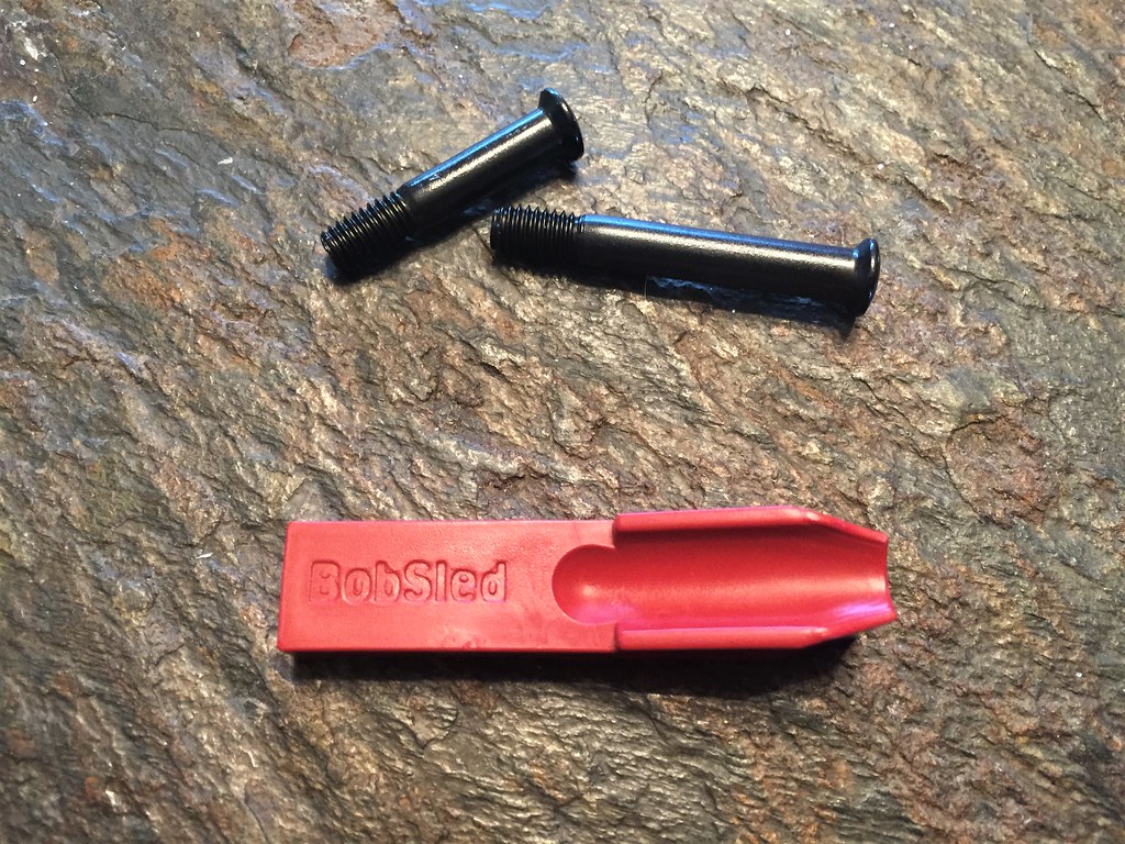

Couple of additions came in the mail today from Mountain Tactical. Got the Bob Sled for the mag and a set of hardened action screws. Don't really know if the screws are needed but I figured some hardened screws couldn't hurt.
The Bob Sled fits perfectly and works just as well. I prefer to single load so it's just about a must.

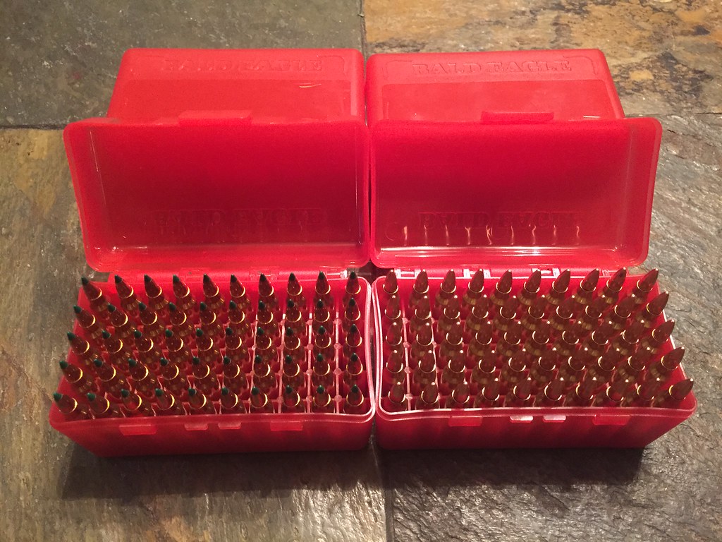

Also got my .223 ammo boxes from Bullets.com. They had them on sale for $2.25 this week so couldn't pass them up.

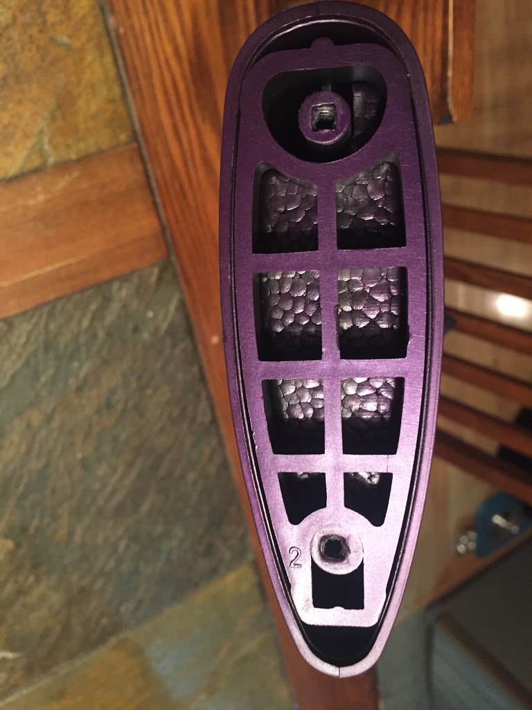

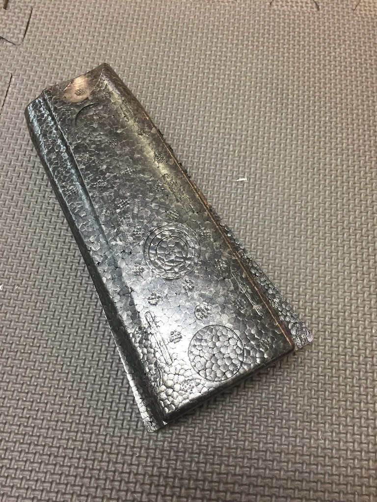

Just about the only thing that I didn't like about this new rifle is the balance or lack there of. Definitely much too muzzle heavy especially with the bipod. Even though I'm bench or prone shooting I still wanted it to be balanced better.
Tikka fills the butt with a chunk of foam.
With some help from a newly found friend on the Tikka page on FB I finally realized that the spacer in the butt was just pressed in. I removed it and wrangled the foam out of the stock.

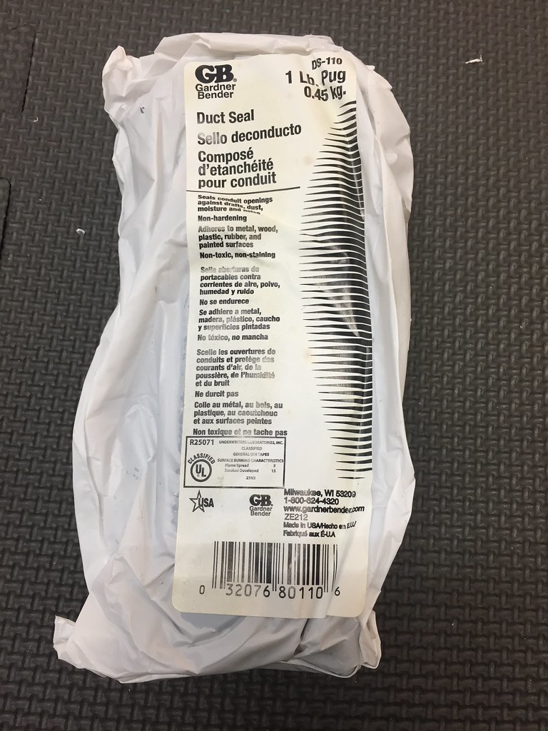

After debating all kinds of fishing weights, bulk lead shot and so on it finally dawned on me that perhaps I could use duct seal. It's a silly putty like substance that comes in 1 lb. blocks. You can get it in the electrical section at any of the big box stores. I use it inside pellet traps for my air rifles.

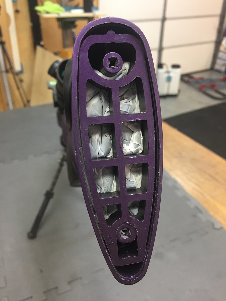

Turns out that 1 block is the perfect weight and perfect amount to barely squeeze into the hollow butt stock. Definitely want to leave it in the package or put it in a baggie or similar as it's kind of oily.
I just pressed it in with my thumbs to form it to the stock and replaced the spacer and butt pad.
The rifle is perfectly balanced holding it just in front of the magazine now with the bipod attached.

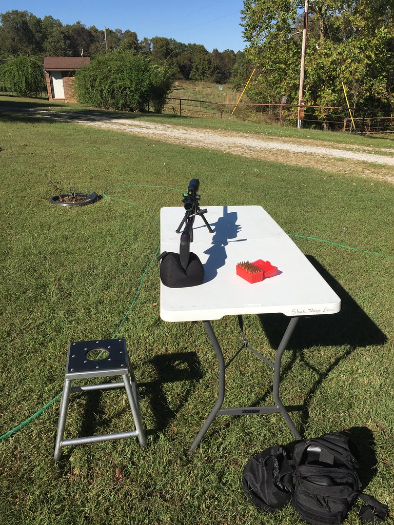

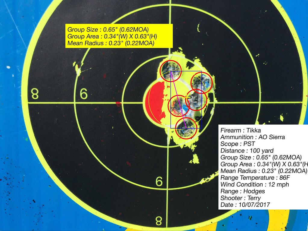

Few things verified this afternoon. I still suck as a shooter and that is compounded by not being comfortable. I'm going to have to build up the cheek rest on this stock for sure. Could never get a solid weld that I could repeat with any consistency. Felt like my head was just floating. With that being said, I think this little gun is going to be a shooter once I get that issue sorted.
Shot the Australian Outback 55 gr Sierra Blitz @ 100 yards. 12 - 15 mph 45 degree head wind. Shot off a folding table with bipod and rear squeeze bag.
Several groups of similar size. This being about the best. Could get 2 or 3 in virtually the same hole but could never put 5 good shots together.
Suggestions are welcome on something decent to extend the cheek weld. Probably need 1/2" more minimum. Will have to be easily removable to clear removing the bolt. Scope is already on low rings. I actually had to mill the rear of the rail to clear the throw lever strap. I am planning on changing the 0 moa rail to a 20 moa. Going to need more vertical adjustment at distance.
Clamp a board in front of the bipod legs & then gently put forward pressure while shooting.
Weight the table down w/ something heavy.
I've actually shoot off that table quite a bit. Not the best but I'm used to it and it works in a pinch. I will shoot it prone or from a real bench at the range most of the time. I just had to shoot it today and really tough to shoot prone at my buddy's house given the fence and his lack of mowing.
