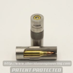

You need a case gauge and then work backwards from there. I like the Sheridan Slotted Gauges.
This is the gauge I would buy if I had to buy new gauges again. Without a doubt, this is a five star design. Very very practical. The only thing that could be better, is if you had the gunsmith make you an exact copy of the barrel they chamber for you. But if the reamers are to Spec. Then not sure it really is better. Maybe better for a custom chamber.
I think a case gauge like this one is very difficult to tell how much headspace a case has. You have to use your Mark II finger tip or eyeball to tell if the case is above, same or below SAAMI max. It doesn't tell you how the resized case fits your chamber. There's .006 difference between SAAMI min and max.
