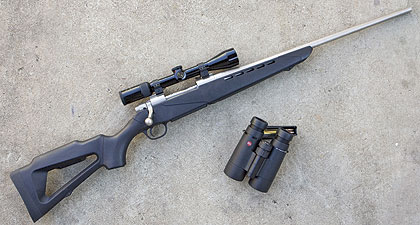

If you're looking for inexpensive the Mossberg 4X4 is the least expensive 24" barreled 25-06 Remington factory new rifle I've come across. The skeletonized stock is something different, I'm not personally familiar with this model.
A review
