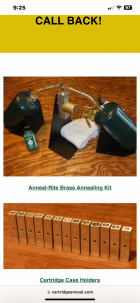

I use 2 propane torches (Anneal Rite, see attached pic) and I’m stopping about 1-2 sec after the 750 Tempilaq turns color. Important to turn off any air circulation. Uncertain about this but my recollection is that the Tempilaq 450 on my cases is not changing color quite as far down as yours, so maybe drop back on time a little. Anneal Rite provides aluminum blocks that absorb heat from the lower case body (see pic), seems like a great approach to me.
