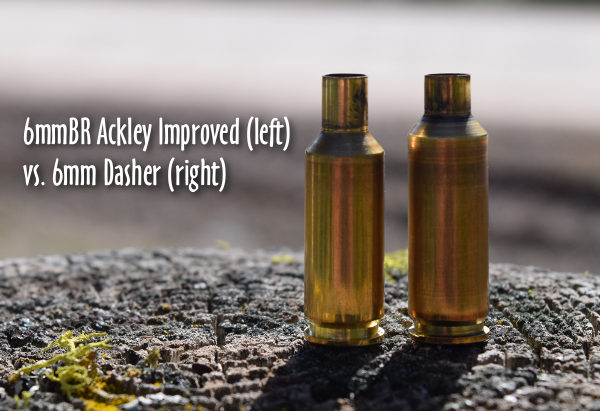

All I can tell you is that the node is 2980-2990 in a BRA. I do not have experience with the brdx. The point with the brass is making good brass. When guys make dasher cases the screw them up. If your lengths are not coming out within one or two thousandths after forming you have made inconsistent brass. Hydro forming was great, very good cases. The BRA makes good cases no matter what. It really is a better case. I have not chambered a dasher since the first bra if that tells you anything about how its catching on...
So now that everyone is shooting BRA and it starts breaking records. That will make it better than the Dasher?
6mm BRA should just be the 6mm BR re-shouldered to an Ackley Improved angle. (~40* shoulder angle) Same as the Dasher, just shorter..
I'm not sure its 100% standard yet, the length to the shoulder has some variations. Maybe Alex can chime in there.
